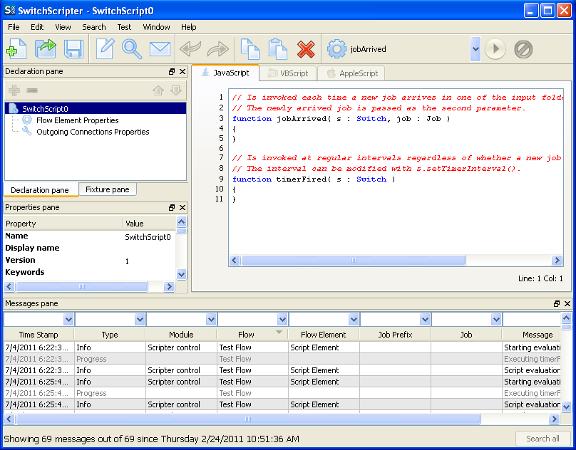

The SwitchScripter window offers a workspace with the following important areas (each of which is discussed in a separate topic):
Workspace area
Description
Toolbar
Contains tool buttons for the most frequently used functions
Declaration pane
Allows editing the script declaration, defining support for connections, injected properties and so on
Fixture pane
Allows setting up an emulated test environment so that you can test-run a script without attaching it to a flow
Properties pane
Serves to edit the properties of the item currently selected in the declaration or fixture pane
Program pane
Allows editing your script program in any of the supported scripting languages
Message pane
Displays log messages issued by your script or by the emulated run-time environment during testing
The various panes can be shown or hidden by choosing the corresponding item in the View menu. Panes can be resized by dragging the separators between them, they can rearranged next to one another or overlaid as tabs by dragging their title bar and they can be undocked as a floating pane. All configuration settings are persistent across sessions.
