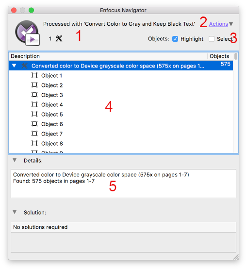

The Enfocus Navigator consists of the following screen parts:
# Description
1 Name of the Action List, Global Change or Preflight Profile and the number of changes. In the above example, only one change has been carried out.
The icon indicates that the change was successful. In case of problems, you may see (Warning), (Error which can be signed-off) or (Error).
2 Click the Actions link and select Show Report to view a Report with information about the PDF being processed (e.g. document properties, security information, the performed Actions,...).
Note: If you have used an Action of the type "informs", you should open the Report to find the information you wanted to collect with the Action List!
3 Select the checkboxes if you want to highlight and/or select the objects that have been affected by the performed Actions, Global Change, or Preflight check.
4 The Description section indicates which objects have been changed. Select a line to see the corresponding details in the Details section below. This way you can browse through the results.
Note: It may be handy to use this browser in combination with the Enfocus Inspector to see more details about a particular problem or to correct the problem immediately. For more information, refer to "Browsing throught the results" in the PitStop Pro Reference Guide.
5 The Details section provides information about the items selected under Description.
6 The Solution section allows you to fix problems, in case of warnings or errors. For example, if an Action of the type "Check" has detected a font problem, you will get the possibility to select an alternative font and change the font immediately.
