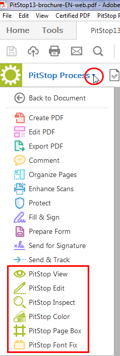

    • If another panel has been opened already, click the small arrow below the name of the panel and select the PitStop Pro panel you want to open (see screenshot below).
