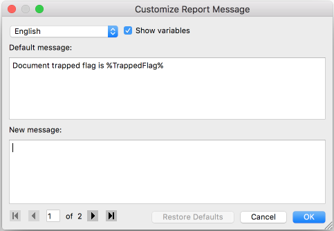

  2. From the menu, select Customize report message. The Customize Report Message dialog appears.
  3. From the list at the top, select the language for which you want to change the message. Select All if you want to display a particular message regardless of the PitStop language. The default message is displayed in the first field. If the message contains variables, you can make them visible by selecting the Show variables checkbox: the variables are enclosed in % signs. To preview the end result (variables replaced with the actual values), you should clear the checkbox again.
  4. Enter a new message in the second field.
    If you don't, the default message will be used.
    Tip: We recommend copying the message from the first into the second field (making sure Show variables is selected). That way you're sure the variables are written correctly. If a variable contains a typo, it will not be recognized as such and it will be considered a fixed string.

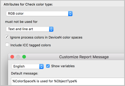

    • Built-in configuration variables refer to the options in the attributes of the Action. If you clear the Show variables checkbox, you can see what they refer to. In the example below, %ColorSpace% refers to the value chosen from the first list (RGB color), whereas %ObjectType% refers to the value chosen from the second list.

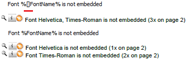

    • Square brackets such as "[]" inside a variable indicate that the variable may be replaced with more than one value, depending on what's found in the PDF. For example, "%[]fontName%" means that more than one font name may be mentioned in the message. If written like this, the font names are listed, one after the other. If the square brackets are removed, you'll have a separate message on a separate line for each different font name. See the example below:

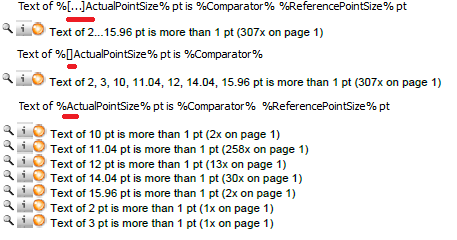

    • Square brackets enclosing 3 dots such as "[...]" inside a variable refer to a range, e.g. %[...]ActualPointSize% means that the smallest and the largest point size found in the document will be mentioned in the message, separated by three dots. Values inbetween will not be mentioned. If you remove the three dots, all values found in the document will be mentioned (separated by a comma). Alternatively, you could remove the square brackets, resulting in one separate message per point size value. See the examples below:
      Note: Make sure to use the correct notation; if you omit one dot, or write 4 dots, this will not work!
