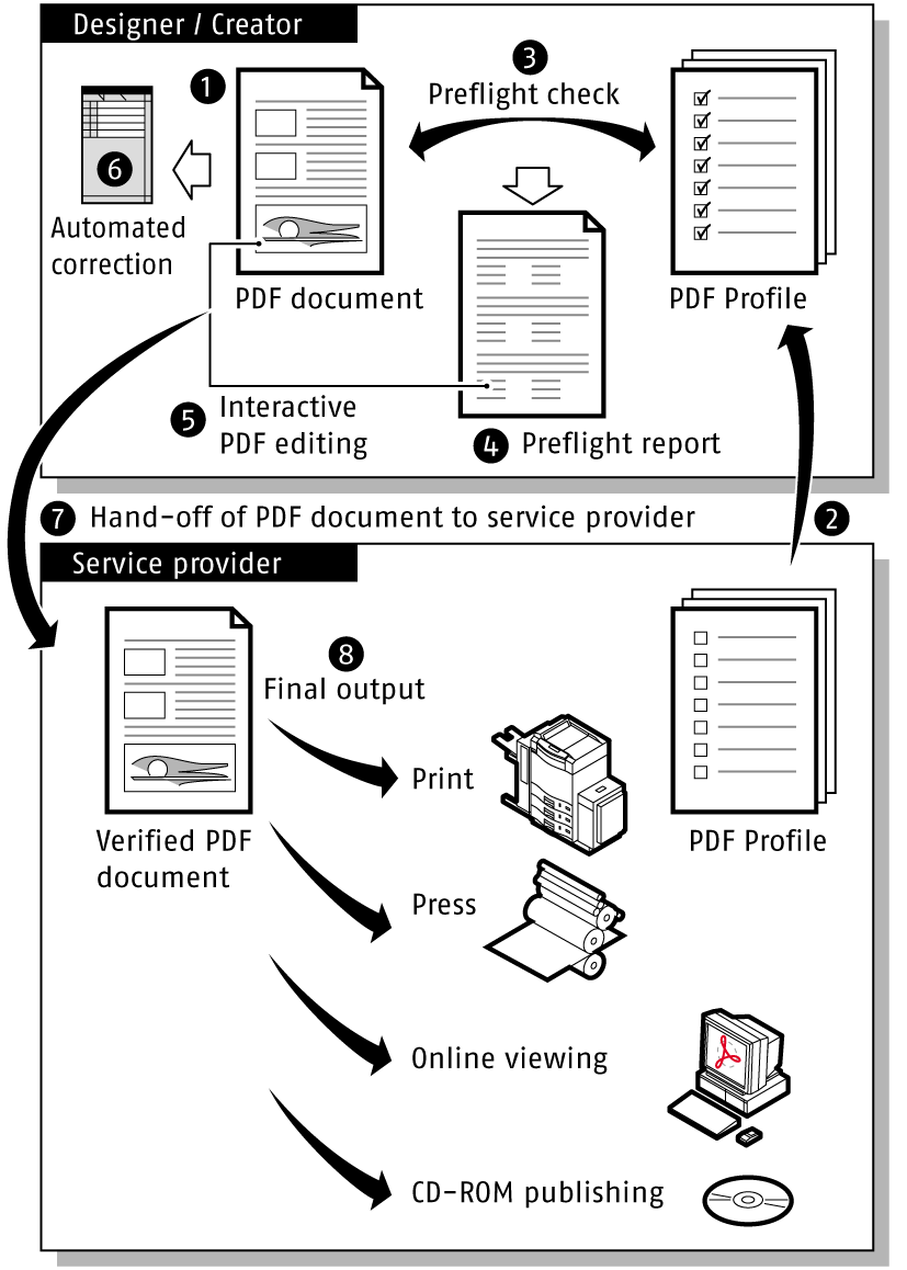

How exactly does preflighting work in PitStop Pro ? The typical stages in a preflight check are the following:
Figure 1. Typical preflight workflow with PitStop Pro
  1. Open the PDF document which has to be checked.
  2. Create a new Preflight Profileor select an existing one.
  3. Have PitStop Pro check your PDF document against the Preflight Profile and automatically fix a number of detected problems.
  4. PitStop Pro generates a preflight report.
  5. If necessary, interactively resolve detected problems which were not fixed auto­matically in the PDF document.
  6. If necessary, use Action Lists to perform a number of (advanced) automated cor­rections in the PDF document.
  7. Hand off the verified PDF document to your service provider.
    The service provider receives an output-ready PDF document and takes it to the final output stage, for example, for print, press or online viewing.
