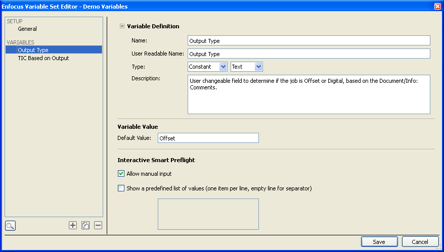

![]() The constant value defined here sets the default value to "Offset" |

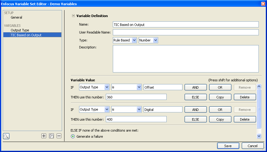

![]() In the Variable value, the constant variable is selected to start the rule statement. In this example, the rule is expanded to two variables "Offset" and "Digital" with each having their own values. If the constant variable which you select here had predefined values set for it (using Interactive Smart Preflight functionality) then those values will be readily available to you here in a dropdown menu. |

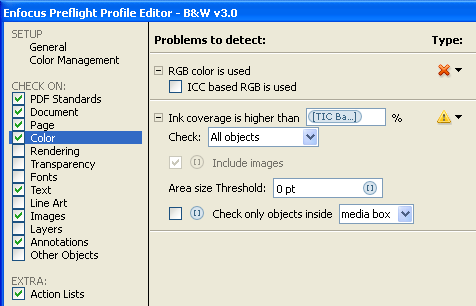

![]() For this check, the Rule based value has been assigned to the Color Ink coverage value. Depending on the previous setting, this value will be set automatically, however the value can still be manually overridden if required when the Preflight Profile is run. |

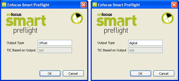

![]() When the Preflight Profile is run, the user is presented with the option to modify the variable parameters. In the case of our Rule based variable (TIC Based on Output), entering the right value in the "Output type" will automatically trigger the correct value for the Total Ink Coverage. |
AND and OR statements will add a condition to the selected statement. Making so the statement is dependent on two or more conditions.
ELSE adds an alternative statement to the overall variable, and there is always an exception ELSE statement at the end of the argument so that any exceptions are handled with a preflight error or with a default value.
