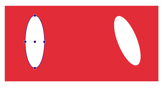

  1. Click the Edit Path tool.
  2. Click the line-art object of which you want to edit a path.
    The anchor points of the path become visible, but are not selected yet.

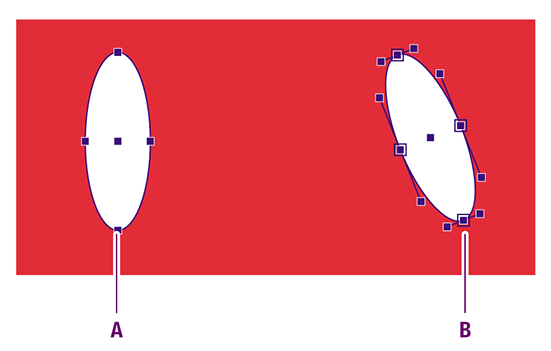

  3. Do one of the following:
    • Click a specific anchor point a second time.
    • Hold down the SHIFT key and click a number of anchor points a second time.
    • Drag a dotted rectangle (marquee) around one or more anchor points.
    The anchor points will be selected only if you click them a second time or if you drag a marquee around them. A selected anchor point will appear larger and its direction points will become visible.
    A: Visible anchor points which are not selected
    B: Selected anchor points with their direction

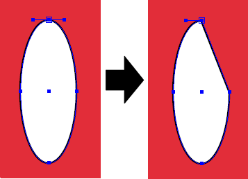

  4. Drag the anchor point or its direction point to the required position to change the shape of the segment.
    Example: Dragging a direction point to change the shape of a segment.
    Remark: Curved segments will remain curved (as in the preceding screenshot) and straight segments will remain straight.

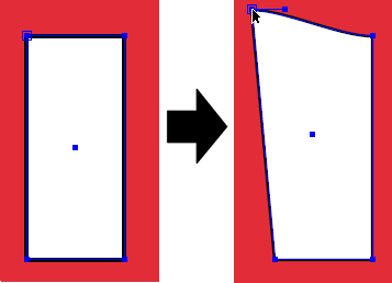

    To change a straight segment into a curved segment, you have to select the (line) anchor point and change it to a curve anchor point (by choosing PitStop Pro > Object > Set Curve Anchor Point ) before dragging it to a new position.
    For example, in the image below, the top left anchor point has been selected and set to a curve anchor point. By dragging this anchor point to a new position (moved up and to the left), the straight line becomes a curved line.
    Example: Changing straight lines to curved lines

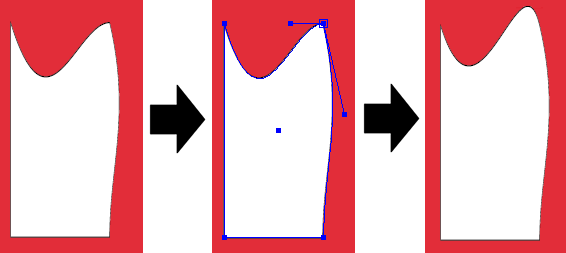

    To change a curved segment into a straight segment, you have to select the (curve) anchor point and change it to a line anchor point (by choosing PitStop Pro > Object > Set Line Anchor Point ).
    Example: Changing curved lines to straight lines
    Note: The lower left anchor point of a path cannot be changed, because this is the start point of the path. The option Set Line Anchor Point/Set Curve Anchor Point will be grayed out. If you do want to use this point to change the shape of a segment, you should change the direction of the path using PitStop Pro > Object > Reverse Path .

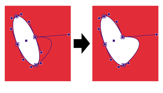

    To smoothen the curve in an anchor point, select the anchor point and click PitStop Pro > Object > Smoothen Anchor Point , as shown in the example below.
    Example: Smoothening an anchor point
