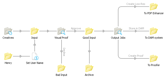

Example flow
Here's a simple flow example as it is shown in the PowerSwitch canvas:
Since this example focuses on SwitchClient features, there is a lot of interaction with human operators and little automated processing (other than moving jobs around). Real-life flows would probably include processing steps such as preflight or color conversion.
The submit point to the left (Creatives) allows submitting jobs to the flow in a controlled fashion using SwitchClient. The user's name is automatically remembered; multiple users can use the same submit point since each user is identified to PowerSwitch through his/her user name and password. The "Set User Name" script serves to add a user name for jobs submitted through a regular hot folder (Henry).
The first checkpoint (Visual Proof) holds the incoming jobs for inspection by a SwitchClient user. The names of the output connections (Approve and Decline) are displayed in SwitchClient as buttons. Pressing one of these buttons moves a job along the corresponding connection.
The second checkpoint (Output Jobs) allows a SwitchClient user to decide how the jobs will be stored or processed. This checkpoint is configured to allow multiple outputs at the same time; for example both "Store in DAM" and "Create Proof".
