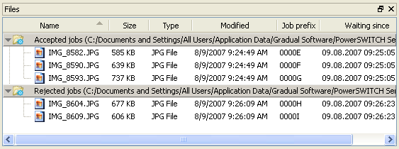

Each row in the files pane represents a file or folder as described in the following table. Folder rows offer a triangle button to show/hide the rows representing the contents of the folder.
Icon |
Row represents |
Information displayed |
The backing folder of a flow element |
Flow element name and backing folder path |
A job folder (*) |
Folder info; Job info |
A job file (*) |
File info; Job info |
A regular folder |
Folder info |
A regular file |
File info |
The rows in the files pane have multiple columns as listed in the following table. Individual columns can be shown or hidden through the "Show columns" context menu item. By default, only a subset of the columns is shown.
The visible columns can be resized and reordered by dragging. Clicking on a column header selects that column as the key for sorting the rows in the files pane, and toggles between ascending and descending order. Rows that have the same parent (and thus are on the same hierarchical level in the tree) are sorted according to this specification. Root rows are always sorted on the name column (ascending or descending depending on the last setting).

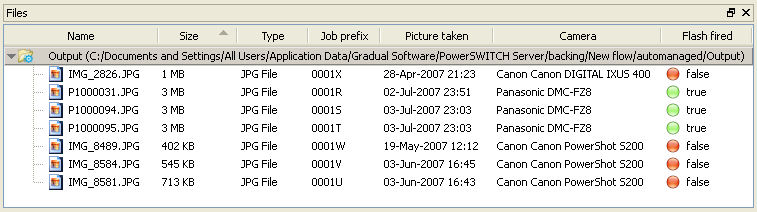

Custom 1 ... Custom 5 |
A user-configurable value calculated through variables or a script expression Both the column header and the column value can be configured through the context menu items "Set column header" and "Set column value (first make the column visible with the "Show columns" context menu item) Initially the values for these columns are blank |
In the following example, two custom columns were configured to display the date when the picture was taken and the camera model (see defining text with variables).
A third custom column was configured to display whether the flash fired when taking the picture (see defining a condition with variables).
