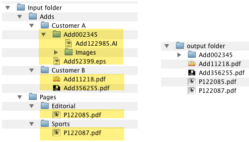

In the example underneath you can see the input folder and the corresponding output folder, using Subfolder levels set at 2.
