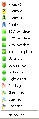

The rightmost column in the flows pane can display a marker icon selected from a predefined list of icons (including colored flags, priorities, and level of completeness indicators). You can set these markers at your discretion to help organize your flows (for example, indicate work in progress). The markers have no meaning to Switch.
If you do not want to use markers, you can hide the marker column with the "Marker column" context menu item.
