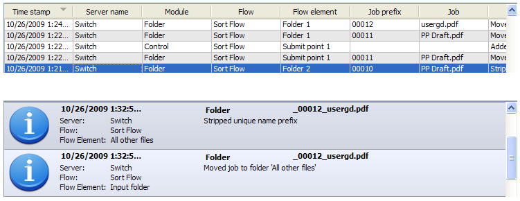

When the messages icon in the task bar is selected, the SwitchClient window adjusts to show a list of log messages issued by the PowerSwitch/ FullSwitch server and by the various processes it controls. Using the Toggle Display button choose between List view or Message Card view:
