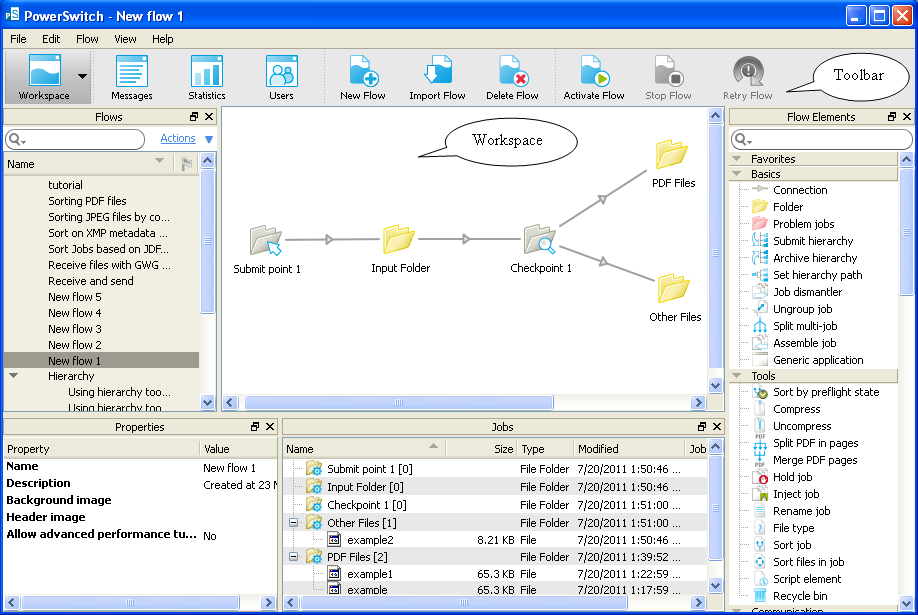

When Switch designer is launched, it displays the main window called the workspace, shown here in its default configuration (design view):
The toolbar is the strip at the top of the workspace offering a number of tool buttons.
See Toolbar for more details.
The workspace contains a number of panes which can be manipulated as distinct entities (show, hide, resize, move, ...). Examples include the flows pane, the elements pane, and the properties pane.
The central area that displays a flow design is called the canvas; it is a special pane because it has no title bar and it can't be moved from its central position.
One or more panes (optionally including the canvas) combine to make up a workspace configuration called a view. The currently displayed view is selected by pressing one of the buttons in the leftmost section of the toolbar.
The workspace offers a number of panes that are displayed in a number of pre-configured views. Each of the views can be configured at will to display an arbitrary combination of panes. The contents of a pane persists across views (i.e. the different views display the same instance of the pane rather than different copies).
Panes can be shown or hidden by choosing the corresponding item in the menu. Panes can be resized by dragging the separators between them, they can be rearranged next to one another or overlaid as tabs by dragging their title bar, and they can be undocked as a floating pane. All configuration settings are persistent across sessions.
The currently displayed view can be returned to its pre-configured settings by selecting .
