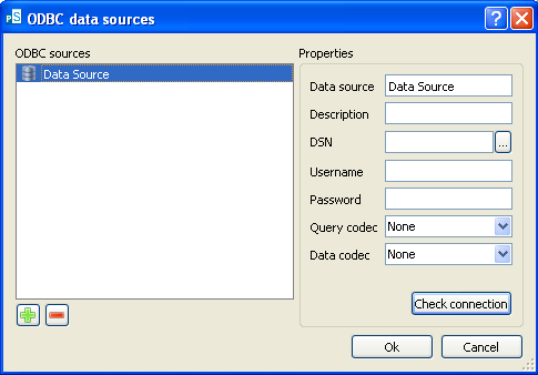

Connect to the preferred database by configuring it in the ODBC data sources of the User Preferences dialog box
button to select the DSN (Database Source Name) from the library. The data
source name should be defined in the DSN settings of your operating system. For
