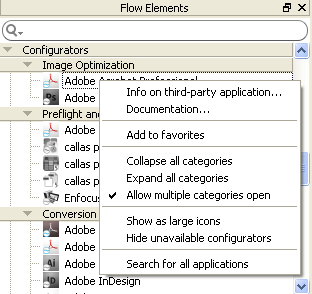

If during startup Switch does not detect a third-party application that has been successfully installed, you can trigger a search for the application through the context menu offered by the Flow Elements pane (as shown above). You can also use this function if you did not quit and restart Switch after installing a third-party application.
To search for the third-party application corresponding to a configurator:
This function first attempts to detect the third-party application using fast mechanisms and if that fails, it performs a full file search in the system's program files folder.
Some configurators do not offer this function or may not offer the full file search capability.
