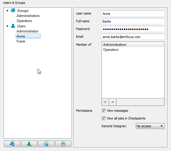

The Users pane consists of two parts:
- In the left part of the pane, you can configure users and user groups,
and assign them permissions for SwitchClient and Remote Designer.

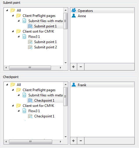

- In the right part of the pane, you can grant users and user groups access to
particular Submit points and Checkpoints. This part is only visible, if
you have activated the SwitchClient and/or the Web Services module.
