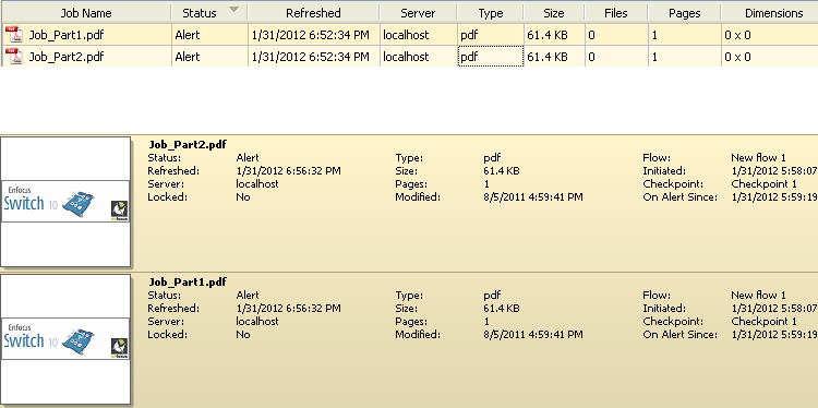

When user selects the Jobs icon in the task bar, the SwitchClient window adjusts to show a list of jobs issued by the Switch server and by the various processes it controls. Using the Toggle Display button, choose between list view or Job Card view:

Toggle display
Each click toggles a job view and users can select among the following three types:
  • small card view
  • large card view
  • table view
