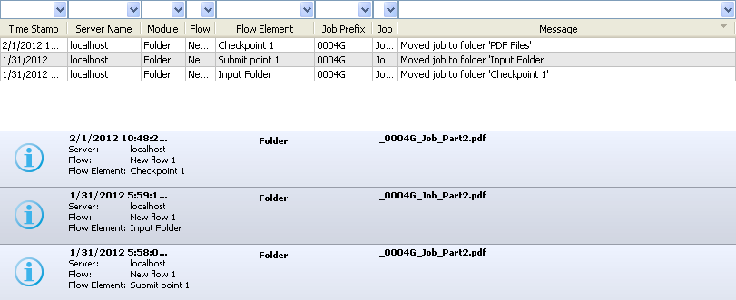

When the messages icon in the task bar is selected, the SwitchClient window adjusts to show a list of log messages issued by the Switch server and by the various processes it controls. Using the Workspace button choose between Small Card view or Table view:

Type search strings in the filter fields at the top of the message pane to select the subset of messages to be displayed. To sort the table rows on the values in a particular column, click on that column's header. To rearrange the table columns, drag the column headers around.
