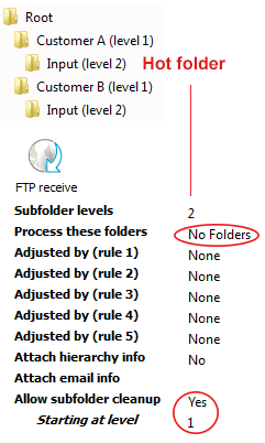

Allow subfolder cleanup
If set to Yes, empty subfolders in the hot folder will be removed starting from the level defined in the next property (Starting at level).
Note: This option is useful if Process these folders is set to No Folders (see higher), because in that case only files are taken from the FTP, while (empty) folders are left.
Starting at level
The folder level (inside of the hot folder) where the folder cleanup should start:
  • Level 1 deletes all empty subfolders in the hot folder
  • Level 2 deletes all empty subfolders of subfolders of the hot folder
  • etc.
In the example below, empty subfolders in the hot folder (= Input (level2) ) will be removed.
