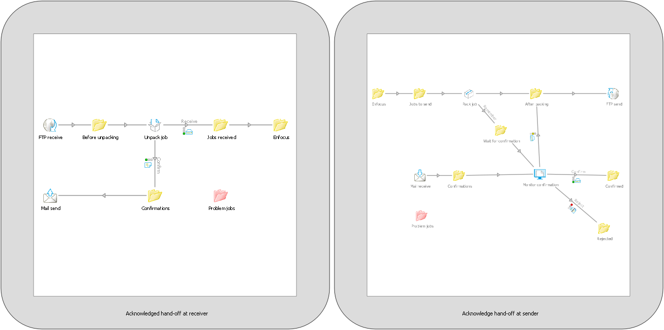

To hand over jobs from flow A to flow B:
In flow A, create a user-managed folder with no outgoing connections and make sure its "strip unique name" property is set to No.
In flow B, create a user-managed folder with the same backing folder (the folder in flow B may or may not have incoming connections).
