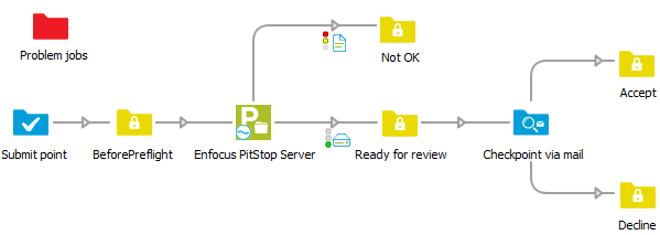

Example flow
In the above example, jobs are submitted via a SwitchClient Submit point. They are preflighted using Enfocus PitStop Server, and moved to two separate folders, depending on the outcome of the preflighting.
Files that are preflighted OK, are moved to the Ready for review folder element and will be presented to the customer for approval. This works as follows:
  1. As soon as a job arrives in Ready for review, a message is sent to the customer (i.e. to the email address in the To addresses property of Checkpoint via mail) - see the example mail below.
  2. The customer has the chance to review the job (optionally, the job files are attached to the email) and sends back a reply that contains the job ID and the Checkpoint action of his choice (Accept or Decline) in the specified format- see the example reply below.
  3. As soon as Switch receives the reply, the job that was waiting in the Ready for review folder is moved to the corresponding folder.

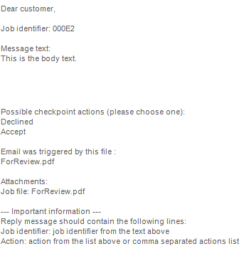

Example Mail
Example Reply
