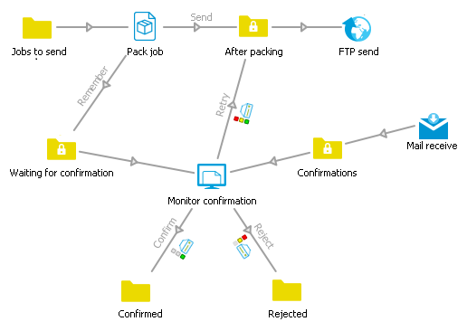

Example flow on sender's side

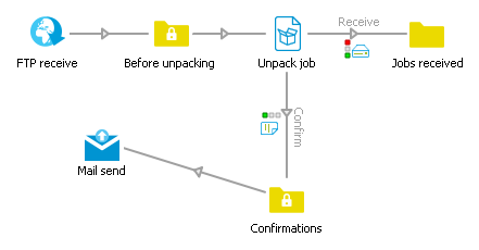

Example flow on receiver's side
