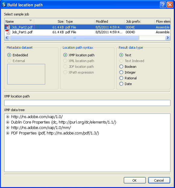

The "Build location path" dialog offers assistance with building location paths for the variables in the Metadata group using picked up metadata by a sample job. The dialog supports the various data models known in Switch.
See also XMP location path syntax.
The property editors Defining text with variables and Defining a condition with variables show a button called Build location path when a variable in the Metadata group is selected and at least one valid sample job is available (See Working with sample jobs).
When you click this button, the Build location path dialog is displayed. When you click the OK button after some modifications, the selected Metadata variable is updated accordingly.
This section lists the various datasets associated with the job. You can select the embedded dataset (which is always available, even if it is empty) or one of the external datasets associated with the job (if any).
The data model for the selected dataset determines the available options for the location path syntax. Unavailable options are automatically disabled in the user interface.
The selected location path syntax determines the layout and behavior of the dialog's bottom portion, as described in the following sections.
The result of the location path configured in the dialog's bottom portion (evaluated in the context of the sample document) determines which Result data type options are available. Unavailable options are automatically disabled in the user interface.
The selected Result data type determines which of the variables in the Metadata group is used to produce the result.
For the choices "XMP/XML/JDF location path" the bottom part of the dialog displays the following two items:
An editable text field labeled "xxx location path".
A tree view representing the metadata in the sample document, labeled "xxx data tree".
You can expand and collapse the nodes in the tree view, but the tree is not otherwise editable.
When you select a node in the tree view, the dialog displays the corresponding location path in the editable text field (discarding anything that was already there).
Vice versa, when you modify the contents of the editable text field, and the contents represents a valid location path pointing to an existing node, the dialog selects that node in the tree (and expands and scrolls the view to make it visible if needed).
The OK button is enabled only if the location path is valid and the selected node is compatible with the selected result data type; otherwise an appropriate alert message is shown at the bottom of the dialog.
