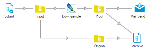

For example, consider this flow:
And the following configuration details:
Submit is configured to remember one level of subfolders, and those subfolders are named for different customers.
Downsample is configured to produce a JPEG thumbnail of the incoming image file.
Proof and Original are configured to add their own folder name at the bottom of the hierarchy location path.
Archive is configured to accept two subfolder levels.
Then the following Submit hierarchy:
Will result in this Archive hierarchy:
Specifically, submitting a file named "File.tif" in folder Submit/CustomerA will result in two archived files (in addition to the proof being mailed out):
The original "File.tif" will be placed in Archive/CustomerA/Original.
The downsampled copy "File.jpg" will be placed in Archive/CustomerA/Proof.
And naturally submitting a file in folder Submit/CustomerB will result in two archived files under the Archive/CustomerB/... structure.
