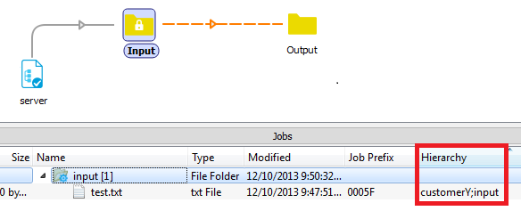

Tip: Use a sample job to see how the saved hierarchy location path looks like. The hierarchy is shown in the Hierarchy column of the Jobs pane.
The Hierarchy column is not by default available. To display this column, proceed as follows:
  1. In the Jobs pane header, right-click one of the column headers and select Show columns > Column1 .The new column (Column1) is now visible in the Jobs pane.
  2. Right-click the Column1 header and select Set column header.
  3. Type Hierarchy and click OK.
  4. Right-click the Hierarchy column header and select Set column value > Define text with variables .
  5. Select Job (from the first column) and Hierarchy (from the second column) and click the Insert variable button.
  6. Click OK.
