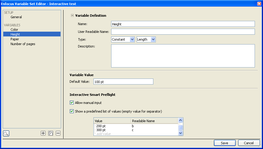

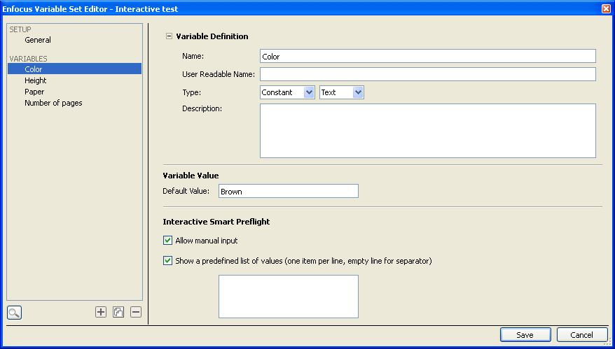

  1. Select the Allow manual input checkbox to enable users to enter the values when they run the Preflight Profile.
  2. Select the Show a predefined list of values checkbox to define a list of values and allow users to select from this list.
    1. If you had chosen Text for the constant variable type then you'll see a multi-line textbox which gets enabled when you select the Show a predefined list of values checkbox. Enter plain text in the multi-line textbox. Press Enter key to type the next value in a new line.
    2. If you had chosen Number or Length for the constant variable type then click where you see the add value text in the multi-line textbox and add the value. If you choose Length then the values will be in the unit of "Points".
      You can mask the value and provide an alternate name for the user by entering it in the Readable Name column. Press Enter key to type the next value in a new line.
      Leave a row blank to insert a line between values as separator.
      You can also change the order of the values by just selecting a value and dragging it up or down and dropping it in the desired position.
  3. Enable the Allow manual input checkbox and disable the Show a predefined list of values checkbox to allow users to manually enter the value in the textbox.
  4. When both the Allow manual input and the Show a predefined list of values checkboxes are enabled, users can not only select a value from the predefined list but can also manually enter the value.
  5. Enable the Show a predefined list of values checkbox and disable the Allow manual input checkbox to force users to select a value from the predefined list only.
  6. Disable both the Allow manual input and the Show a predefined list of values checkboxes to display the value you have entered in the Default Value field in a read-only textbox.

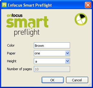

  7. The following example screen shot displays the Enfocus Smart Preflight dialog box which will be displayed to users when they run a Preflight Profile for which a variable set with the above settings has been applied.
