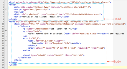

A HTML consists of two main parts:
- HEAD (enclosed in <head> tags) : contains the scripts that control the elements in the
body part and a link to the CSS file.
- BODY (enclosed in <body> tags) : contains the form elements that are displayed when
submitting a job file to the Connector.
The code in the CSS file describes how the body and form part look like.
