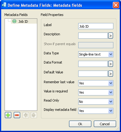

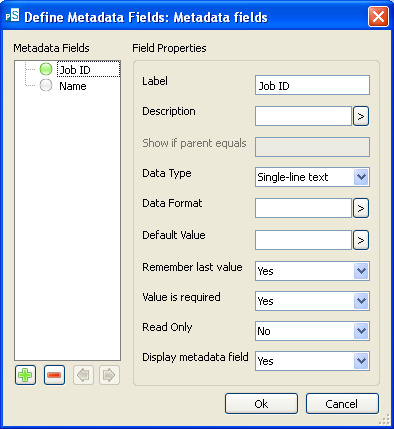

The property editor for editable metadata fields allows creating an ordered list of field definitions (using the buttons under the listbox on the left-hand side). For each field definition, the property editor allows editing the properties described in the table below (using the edit fields and controls on the right-hand side).

| Display metadata field | When set to "Yes" this field is displayed or hidden when set to "No". If set to yes, SwitchClient shows the user a list of values determined by evaluating script expressions in the context of the job (so that the values can be derived from metadata attached to the job); see Using metadata and Defining metadata fields for more information. |
