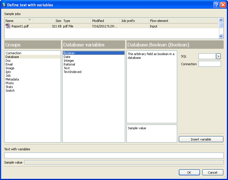

Database Group
The Database group is available in the
Define
Text with Variables dialog box through which Switch offers a library of
variables.
Using the
Define Text with Variables dialog box, user
can:
- Select the Database group, select the type of Database variable
- Modify text
- Build SQL statement
Variable name
Data type
Database.Text
Text
Database.TextIndexed
Text Indexed
Database.Boolean
Boolean
Database.Integer
Integer
Database.Rational
Rational
| Database.Date |
Date |

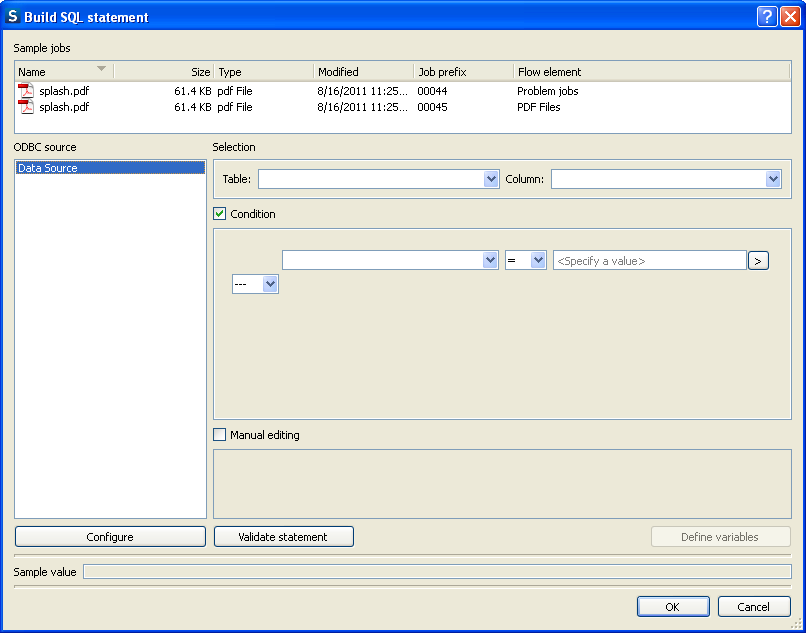

Build SQL statement
Click the
Build SQL statement
option in the fly-out menu which appears when you click this
button beside
SQL textbox in the above dialog box to invoke the
Build SQL statement dialog box.
The above dialog box helps you to,
- Select a data source. Click the Configure button to open the
ODBC data sources dialog box using which you can select a data source
from the list of predefined data sources (refer ODBC data
sources for more information on how to define the data sources).
- Select a table and a column in the Table and the
Column drop-down menus.
- Select the Condition checkbox and specify or select the conditions
in the first and the third menus, choose the comparison operator in the middle drop-down menu
and choose the AND or OR logical operator in the last drop-down menu.
- In order to choose more than one column or to choose a column from any other table or not
to choose any columns, select the Manual editing checkbox and enter the
statement manually.
- After setting the SQL statement, select a job and click the Validate
statement button to check if the query is valid. If the query returns any value
or error, it is displayed to the user.
- The Sample value menu displays the sample value for a query. If a
query returns multiple values, they will be listed in a comma separated list. For example:
"val11,val12,val21,val22...".
- Click the OK button to insert the statement.
