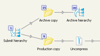

When a flow is active, the canvas attaches a small rectangle to each flow element that has a backing folder, as shown above. The number in the rectangle reflects the number of jobs residing in the flow element's backing folder.
For performance reasons Switch stops counting at 100 jobs. When a backing folder contains 100 or more jobs, the rectangle displays the symbol for infinity.
