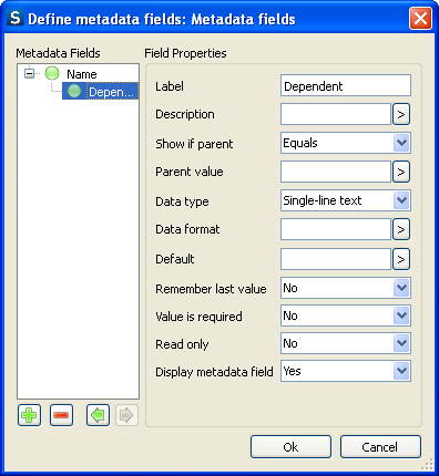

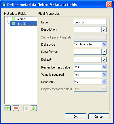

Defining metadata fields
The property editor for editable metadata fields allows creating an ordered list of field definitions (using the buttons under the listbox on the left-hand side). For each field definition, the property editor allows editing the properties described in the table below (using the edit fields and controls on the right-hand side).
Property
Description
Label
The label shown in front of the field.
Description
Description for this field shown as tool tip when user hovers over the label or the data field in SwitchClient.
Show if parent
In the dropdown menu, choose the condition for comparing parent value and dependent value. Options available are:
  • Equals
  • Not equals
  • Contains
  • Does not contain
  • Starts with
  • Does not start with
  • Matches
  • Does not match
Parent value The value (string) of the parent field on which this child field depends. Dependency is set using the arrow keys in the field list.
If you choose the "Matches" option for "Show if Parent" property then regular expression will be used for all parent values.
Data type
The field's data type: Dropdown list (Single-line text, Password, Date, Number, Hours and minutes, No-yes list, Dropdown list).
Data format
Only available when "Data type" is set to single-line text or number. Format the metadata field using a regular expression. Leave empty to not set any special formatting (Single-line text, Regular expression).
Data values Only available when "Data type" is set to "Dropdown list". Define the drop down list (Edit multi-line text, Define multi-line text with variables, Define script expression, Define values from dataset, Define values from ODBC data source).
Default
The default value for the field (Single-line text, Single-line text with variable, Condition with variables, Date and Script expression).
In case "Data type" is Dropdown list with dynamically generated content, this default value might not correspond with one of the list items. In this case the "Default value" is empty in SwitchClient.
In case the "Data type" format and the default values format do not match, Switch tries to force the formatting of the data type property (example, Data type is hour and minute and the Default value is a text variable). If forcing is not possible, the Default value is empty in SwitchClient.
Remember last value
If set to "Yes", SwitchClient displays the value most-recently entered by the user in this field.
In case "Data type" is Dropdown list with dynamically generated content, the previous value might become irrelevant. The previous value is however stored so we can also compare it with the content of the list. If the stored value matches one of the data values, then this value is shown. If the stored value no longer appears in the list, no value is shown.
Value is required If set to "Yes", SwitchClient requires that the user enters a non-blank value (relevant only if Data type is string).
Read only Set this to "Yes" to make this field read only.
Display metadata field
If set to "Yes" this field is displayed and when set to "No" it is hidden. See Using metadata and Defining metadata fields for more information.
Note: For the Checkpoint tool, when a user selects "Define values from dataset" in the Data Values field, the Build location path window appears using which XPath expressions can be created. The regular variables from a dataset returns only one single value where as the result of the XPath can be a list of values.
Note: For the Submit point and the Checkpoint tools, when a user selects the "Define values from ODBC data source", Build SQL statement window appears. The regular variables from database returns only one single record where as the result of the SQL statement can be a list of records.
