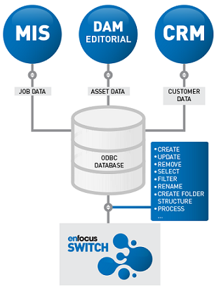

The illustration below shows how data from different types of databases (MIS/DAM/CRM database) can communicate with Switch through ODBC data sources ("connections to the database").

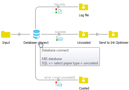

This element allows you to establish a connection with the database of your choice (using ODBC data sources) and to build an SQL statement to determine what data should be collected, added, modified, filtered, changed…
When a job passes through this flow element, the SQL statement is executed. To keep an eye on the changes, you can log the result of the SQL statement.
In the following example, when a job arrives in the Database connect flow element, Switch connects to the MIS database and checks the paper type for the current job. Only if the job matches the SQL statement, the job is “successful” and the job will be sent to the Ink Optimizer. For each job, a log file is created and stored in a separate folder.

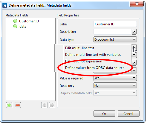

A Submit point (in Switch) or a Connector (created with Connect ALL) can be configured to ask for metadata when a job is submitted. Metadata is additional information about the job, sent along with the processed job in the background as an XML, TXT or CSV file (called Job Ticket). It is often used to store administrative information associated with the job or to exchange such information between systems.
If you have licensed the Database Module, you can define your metadata fields using values from your database (again using an SQL statement).
Note: It is only possible to visualize content from the database, for example the possible values for a particular field. It is NOT possible to extract the correct value for a particular job; the operator who submits a job to a SwitchClient Submit point or a Connector has to select it manually.
