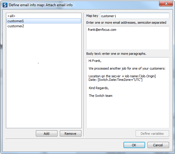

Example 1: Attaching email info through FTP receive
Let's say that you've set up an FTP site where your customers submit jobs.There is a separate subfolder for each of your customers (with the appropriate access rights) and you want to make sure that the responsible account manager is informed.
To achieve this:
  1. Configure an FTP receive flow element. Make sure to check all the relevant subfolders (see "Subfolder levels" property).
  2. Click Attach email info and create an email info map, mapping the name of the customer's subfolder (the "key") to the responsible account manager's email address, as shown below. Note that you could enter the customer's email address as well, as required.
  3. Further in the flow, configure a Mail send flow element (see Using attached email info ).
Note:
  • FTP receive always uses subfolder names as the key, whereas as Mail receive allows selecting the basis for the key ("base map key on").
  • It is possible to have multiple key matches for the same job. For example, if a job is submitted in a nested subfolder some levels deep, FTP receive uses each of the subfolder names in the nested subfolder path as a key in the mapping table. The email information for all matches is combined and associated with the job. This is also the case for the <all> key.

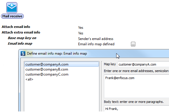

Example 2: Attaching email info through Mail receive
Suppose the jobs in your flows are submitted through mail. You want to attach the sender's email address (for future reference) as well as the account manager's email address.
In order to achieve this:
  1. Configure a Mail receive flow element.
  2. Set Attach email info to Yes, to make sure the sender's email address is stored.
  3. Set Attach extra email info to Yes and configure the subordinate properties:
    • Base map key on Sender's email address.
    • Create an email info map, making sure the keys are your customer's email addresses. Note that the email address in the map key can be either the complete email address or only the part in front of/following the @ sign.
Note: In the above example, jobs from customers that are NOT in the list will match the <all> key. Jobs from customers that are listed, will be associated with the corresponding email address info AND with the info behind the <all> key.
