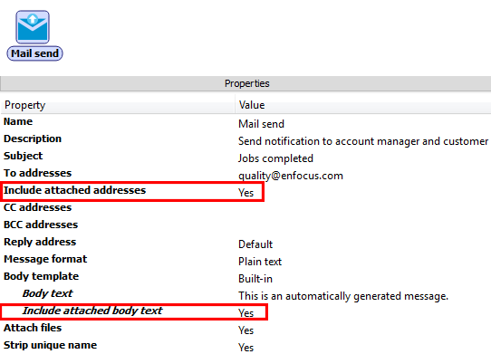

  • You can use the attached info email in the Mail send flow element, using the following properties:
    • Include attached addresses
    • Include attached body text
Example
Properties:

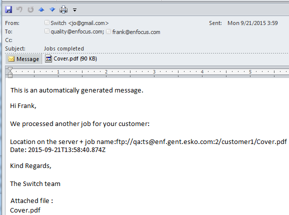

Below is an example of a mail sent via a Mail send flow element with the properties shown higher:
  • The email address in the From field is the address specified in the Switch Mail send preferences (User name property).
  • The To field contains the email address(es) entered in the To addresses property (of Mail send) and the addresses attached to the job concerned.
  • The Subject is the one specified in Mail send - Subject.
  • The job file is attached.
  • The body text contains the phrase "This is an automatically generated message" followed by the email message that was attached to the job earlier in the Switch flow.
Note that this message contains two variables that were selected when configuring the email message: [Job.Origin] and [Switch.Date:TimeZone="UTC"].
