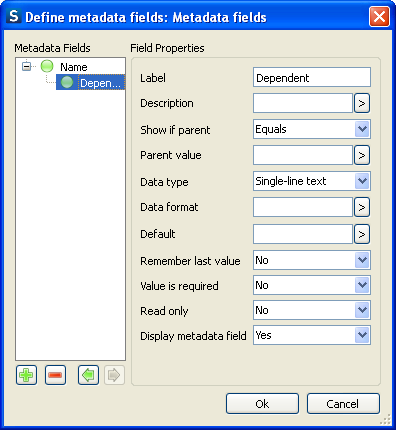

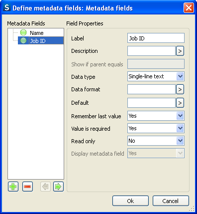

The property editor for editable metadata fields allows creating an ordered list of field definitions (using the buttons under the listbox on the left-hand side). For each field definition, the property editor allows editing the properties described in the table below (using the edit fields and controls on the right-hand side).
Property
Description
Label
The label shown in front of the field.
Description
Description for this field shown as tool tip when user hovers over the label or the data field in SwitchClient.
Show if parent
In the dropdown menu, choose the condition for comparing parent value and dependent value. Options available are:
  • Equals
  • Not equals
  • Contains
  • Does not contain
  • Starts with
  • Does not start with
  • Matches
  • Does not match
Parent value The value (string) of the parent field on which this child field depends. Dependency is set using the arrow keys in the field list.
If you choose the "Matches" option for "Show if Parent" property then regular expression will be used for all parent values.

Remember last value
If set to "Yes", SwitchClient displays the value most-recently entered by the user in this field.
In case "Data type" is Dropdown list with dynamically generated content, the previous value might become irrelevant. The previous value is however stored so we can also compare it with the content of the list. If the stored value matches one of the data values, then this value is shown. If the stored value no longer appears in the list, no value is shown.
Value is required If set to "Yes", SwitchClient requires that the user enters a non-blank value (relevant only if Data type is string).
Read only Set this to "Yes" to make this field read only.
