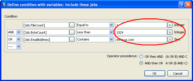

Its more advantageous to compare variables from a job with other variables (for example: from an external source like database or dataset). Therefore, Switch allows users to select multiple variables when setting up a condition. Select one of the following three property editors in the drop-down menu (highlighted in the screen given below):
The example condition is true if the job being tested contains a single file smaller than 1MB or if one of the associated email addresses has the 'enfocus.com' domain.
