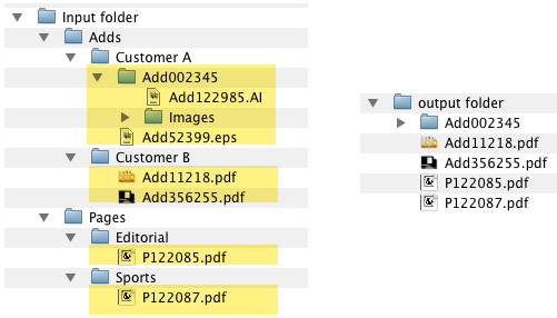

In the example below you can see the input folder and the corresponding output folder, using Subfolder levels set at 2.

Using the Submit Hierarchy function eliminates the need to set up individual input folders on a user by user basis. In the example above, by just adding another sub folder for "Customer C", any job files or folders put in that folder would be seen and processed by Switch without any additional changes to that workflow.
