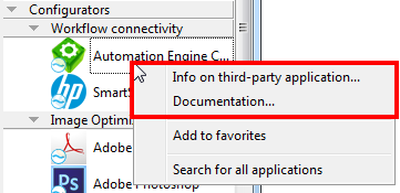

After licensing the Configurator Module, you will see a number of configurators in the Flow elements pane. They are included in the Switch installer and automatically updated if a more recent version is available in the next update.
However, there are many more third party applications that have configurators for Switch. For a complete list, go to https://www.enfocus.com/en/products/switch/partner-integrations-crossroads.
To use these configurators with Switch, you must download and install them.
Note that you must also have activated or licensed the 3rd party application (on the computer that is running Switch Server). Otherwise the configurator may be shown in the Flow elements pane (in gray), but you won't be able to use it.
Note: When installing an application, make sure to close Switch during the installation, or to restart Switch afterwards. This is necessary for Switch to recognize the newly installed application.
